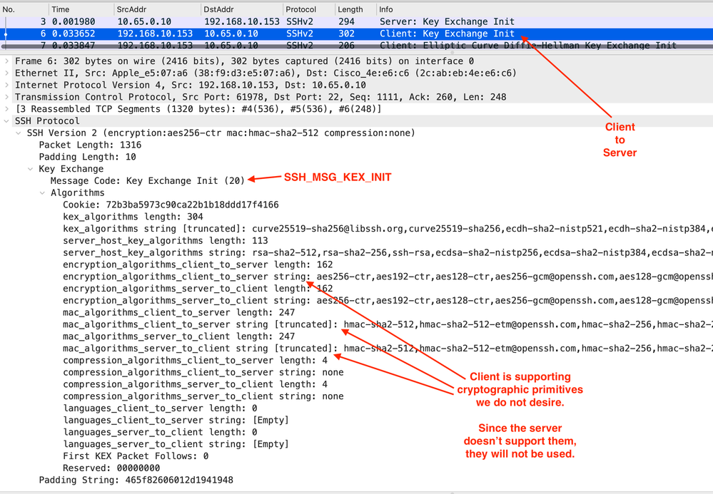

Frame 6
NOTE: We are skipping to frame 6 because there are some TCP packets in the stream that are not relevant to the SSH handshake (ACKs and such) that we won't focus on.
This is the Client to Server Key Exchange (KEX). Notice that the Client is announcing it supports LOTS of cryptographic primitives.  Since we want to avoid 90% of these we configured the server to only support the strongest.

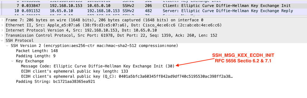

Frame 7
This is the Client to Server Public Key Initialization. The keys in frames 7 & 10 are only used once and then they are trashed.
