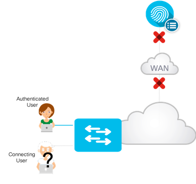

Critical VLAN was introduced to address the situation when the fabric edges are unable to reach the configured RADIUS servers due to some outage such as a WAN outage.  During this outage, authentications are not possible for newly  connecting endpoints.  This feature creates a “fall back” VLAN so that endpoints can successfully onboard and receive some level of access, that’s restricted by policies that you define, during this temporary outage
Functional Overview
  1. New user connects
  2. Switch sends RADIUS traffic which are unanswered
  3. Switch determines RADIUS server is offline and moves the authenticating ports to critical mode.  Voice VLAN=2046, Data VLAN=2047.  (VLAN based SGT assignment is possible)
  4. User gets connected and gains network access based upon locally configured ACLs and/or Group-Based Policies
  5. When RADIUS server comes back online, users in critical vlan are re-authenticated.
Note: Users that are connected prior to RADIUS going offline will remain connected and un-impacted because re-authentication is paused when AAA is detected as offline.   Once AAA comes back online, the user is re-authenticated.

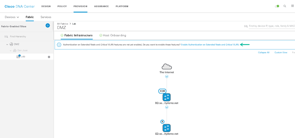

Enable Critical VLAN feature
Cisco DNA Center 1.3.3.1 adds the option to enable critical VLAN functionality. This functionality is enabled per site.  To enable critical VLAN, navigate to Provision-->Fabric--><Site>-->Fabric Infrastructure and click the link to "Enable Authentication on Extended Node and Critical VLAN"
