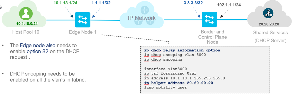

  1. Client from subnet 10.1.18.0/24 sends DHCP request
  2. The DHCP request is sent from the Edge device to the DHCP server adding option 82/Circuit ID.
    The “magic” lays in option 82 which provides additional DHCP information regarding the clients point of attachment, in this case it would be the RLOC loopback address 1.1.1.1 as well as the
    VN-ID 10 (vrf id 10).
  3. The Border will forward the DHCP request via the Fusion Router so it may reach the DHCP server as explained earlier.
Before proceeding with the flow let’s look at the configurations that are needed to accomplish this.
The following configurations are needed to enable option 82 as well as pointing to the ip helper-address.
This is Automated by Cisco DNA Center.
ip dhcp relay information option” – enables option 82 and is also automatically enabled by Cisco DNA Center.
Without this command DHCP in the Fabric will not work.
