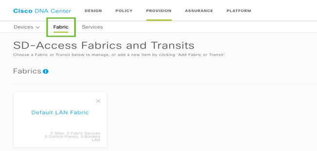

Once Cisco DNA Center has provisioned the SD-Access devices to sites, the SD-Access fabric can be created.  In the Cisco DNA Center UI, navigate to Provision > Fabric.  This is where you create and manage your fabric domains and transits.]

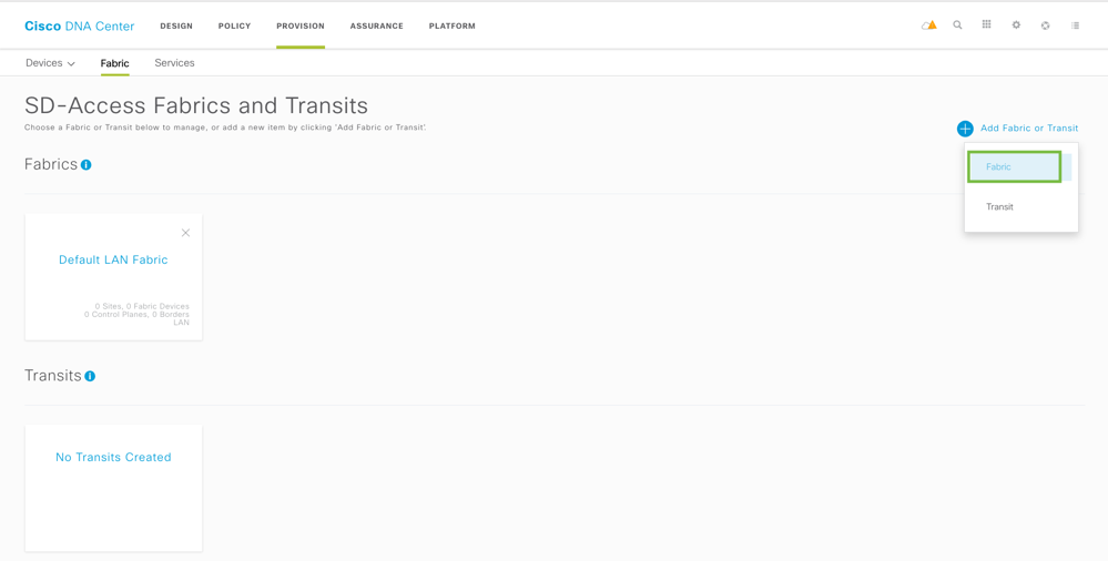

Click on +  Add Fabric or IP Transit to click on Fabric to create a fabric site
Name the Fabric SJC. Click on building - SJC-22. Click on Add.
