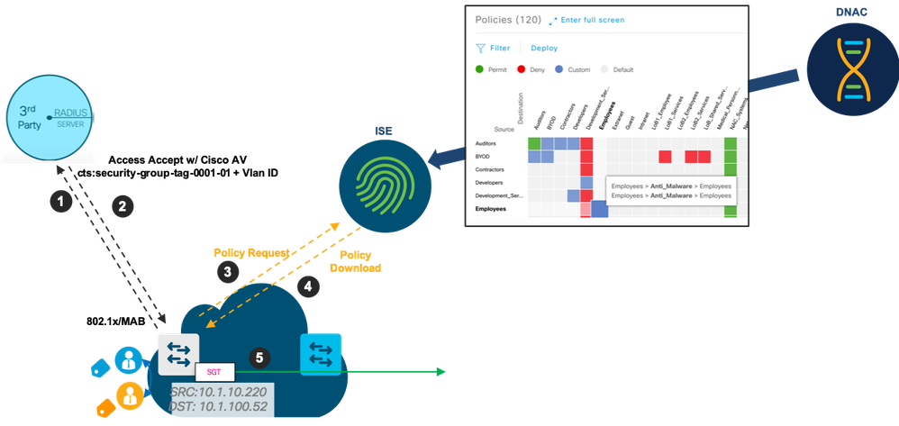

Connection Overview
  1. Users authenticate directly to the 3rd party RADIUS server
  2. RADIUS authorization returns VLAN and SGT
  3. Edge switch initiates a policy request if the policy associated with the newly connected SGT doesn't exist
  4. Edge switch downloads policies
  5. Edge switch enforces and/or traffic forwards traffic deeper into the network
