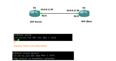

This tells us that the time source is actual hardware calendar-local clock
We want all our devices to be synchronized together if we are able to going to correlate our logs correctly. We set manually clock if you would like to do that.

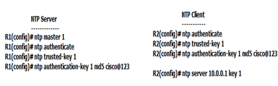

Obviously, manually setting clock is not best practice. We want to point this instead to an authoritative NTP Server.
Now, the server itself should pointed to an external authoritative NTP server as well. It’s usually a public NTP server like US NIST Internet Time Service or it is pointed to an internal NTP server. A Windows Server or Linux server running with NTP service.
These tell us that R2 has 10.0.0.1 configured as the NTP server and it’s currently not synchronized.
This debug tells us that R1 is sending NTP packets, and R2 is receiving anything.
