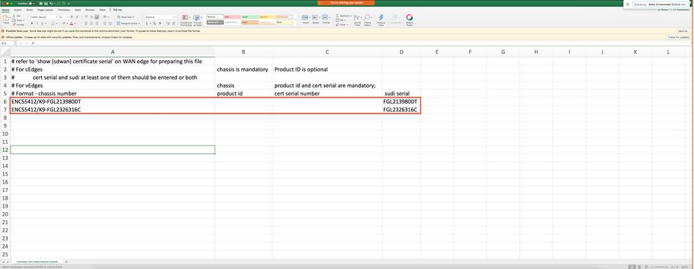

3.2.  Obtain the ENCS device PID and SN using one of the following methods:
a.  In the NFVIS CLI:
nfvis# show platform
b.  Locate the device information on the label on the label tray found on the server chassis.
3.3.  Add the ENCS device info (PID and SN) to CSV file following the format.
3.3.1.  Open the CSV file saved previously.
3.3.2.  Following the format, add the device PID and SN.
3.4.  Upload CSV file into vManage.
3.4.1.  In vManage, go to 'Configuration' -> 'Devices', and then click 'Upload WAN Edge List'.
3.4.2.  Click 'Browse', select your new CSV file in the file manager, and then click 'Open'.
3.4.3.  Check the 'Validate the uploaded vEdge List and send to controllers' option and click 'Upload'.
3.4.4.  When prompted for confirmation, click 'OK'.
3.4.5.  You should receive a success message. Click 'OK'.

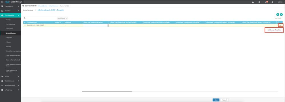

1.  Attach Network Design Template to ENCS Device.
1.1.  In vManage, go to 'Configuration' -> 'Network Design', and then click 'Attach Device'.
1.2.  Click on the device profile in the diagram and select 'Attach Devices'.
1.3.  In the pop-up window, select the device(s) from 'Available Devices' panel and click the arrow button to move them to the 'Selected Devices' panel. Click 'Attach'.
1.4.  On the 'Device Variable' page, click the ellipsis (...) on the right side of the device entry and select 'Edit Device Template'.
1.5.  Fill out all required variables and click 'Update'.
1.6.  (Optional, but strongly recommended). Click the down arrow near the top right to save a CSV file for future use.
1.7.  Click 'Next'. On the Preview page, highlight the device and review the full configuration. Once ready, click 'Configure Devices'.
