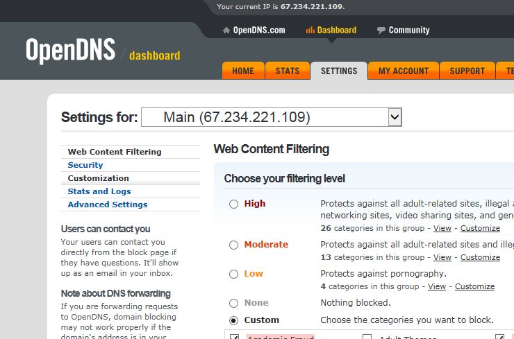

The second nslookup shows that your IP address 67.234.221.109 is not registered with your network at https://dashboard.opendns.com/settings/
Therefore OpenDNS cannot associate your DNS queries with your dashboard settings, and your settings cannot take effect.  If you fix this, content filtering and stats will work, and your problems should have gone.
"When I go to the Dashboard, it claims that it is registered to the account appropriately."
Therefore this statement is not correct.

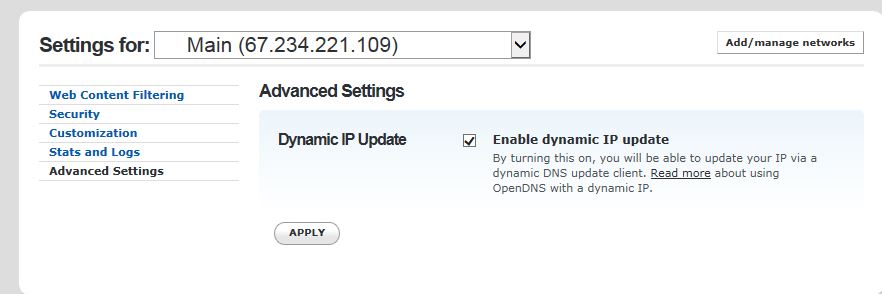

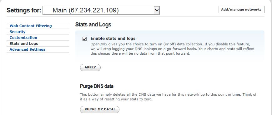

Please see attachments as I provided from my Dashboard settings as well.

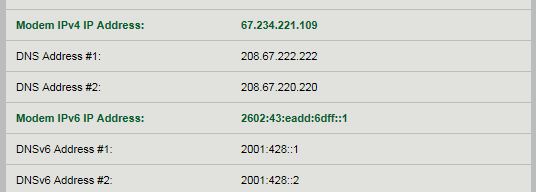

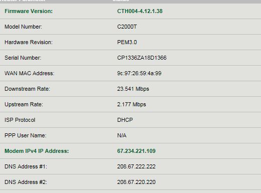

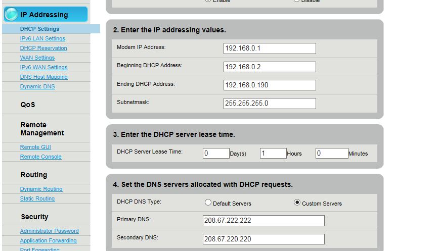

I also provided screenshots of my Router/Modem provided by CenturyLink T2000 series.

One thing you *MUST* do is disable IPv6 on the router. It's entirely likely that all of your DNS traffic is going out via IPv6, in which case OpenDNS will not receive or process any of it for filtering. Even if you were using the OpenDNS IPv6 "sandbox" addresses, which you aren't, those only support name resolution, not filtering or any other services.
Once your traffic is going out via IPv4 to OpenDNS, about 24 hours your stats will start populating.
