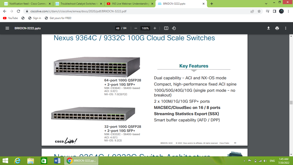

this Nexus model not support breackout.
2 Replies 2

That'll do it! Thanks for the quick response
