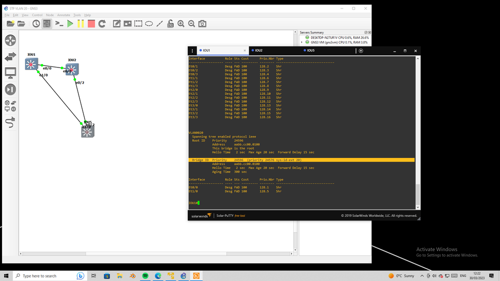

you are correct the answer must be A
I run lab and you can see result below
