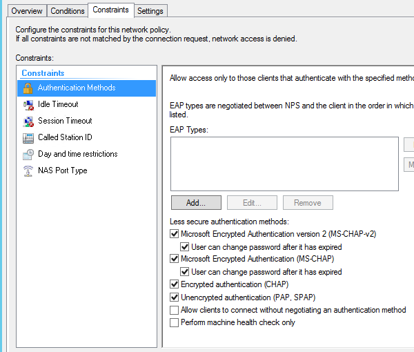

These are the authentication method settings I’m using on the NPS:
Can anyone ■■■■ist? There are no firewalls involved in this setup as it’s in a lab. Both the Auth Proxy and NPS server have two network interfaces one internal to the VM network and one bridged interface out.
