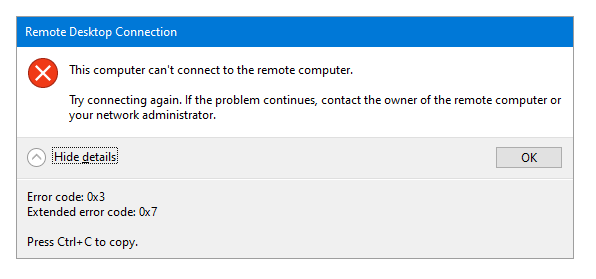

As usual, I'm very confused by the information about Duo for Remote Desktop Services. I've got four clients running the RD Web and RD Gateway combination on Windows Server 2019. They've also received the email that traditional authentication is EOL at the end of the month and to upgrade to Universal authentication.
I've just upgraded RD Web v3 on my test server and after doing this, I can no longer connect using RDP. RD Web is working fine - I've enabled universal prompt there during logon. But launch the RDP and you get the eror below. This article is talking about it but I'm afraid the section "How does Duo Authentication for RD Web affect RemoteApp and Desktop Connections?" is very confusing.

>It's not expected that a regular RDP connection would be interrupted or modified by Duo Authentication for RD Web.
Agreed it doesn't seem to make sense but it certainly does. I've only just had time to get back onto this in my RDS lab and the same problem occurs there. Simply installing RD web v3.0.0 breaks RD Gateway - you don't even have to enable universal prompt in the admin console. In my lab, I got a further error message:

Ohh this is a bit annoying Looks like a restart of the server and/or waiting a while is all that's needed. The first time I restarted the server, I got this new error message:
So I restored the VMware snapshot and started working through the upgrade process again in the lab, taking lots of screenshots. Except this time after the restart I got distracted by another client call and by the time I came back, RD Gateway worked.

Same problem on the production system. After installing RDWeb v3 and enabling universal prompt in the admin console, I was unable to logon with RD Gateway until I restarted the RDS server. I'd left it for 15 minutes before the reboot just in case something kicked in.
Check your Windows event viewer logs. Maybe RDS services hung instead of starting back up when cycled? Did you happen to check the status of the RDS/IIS services on that server before your reboot?
