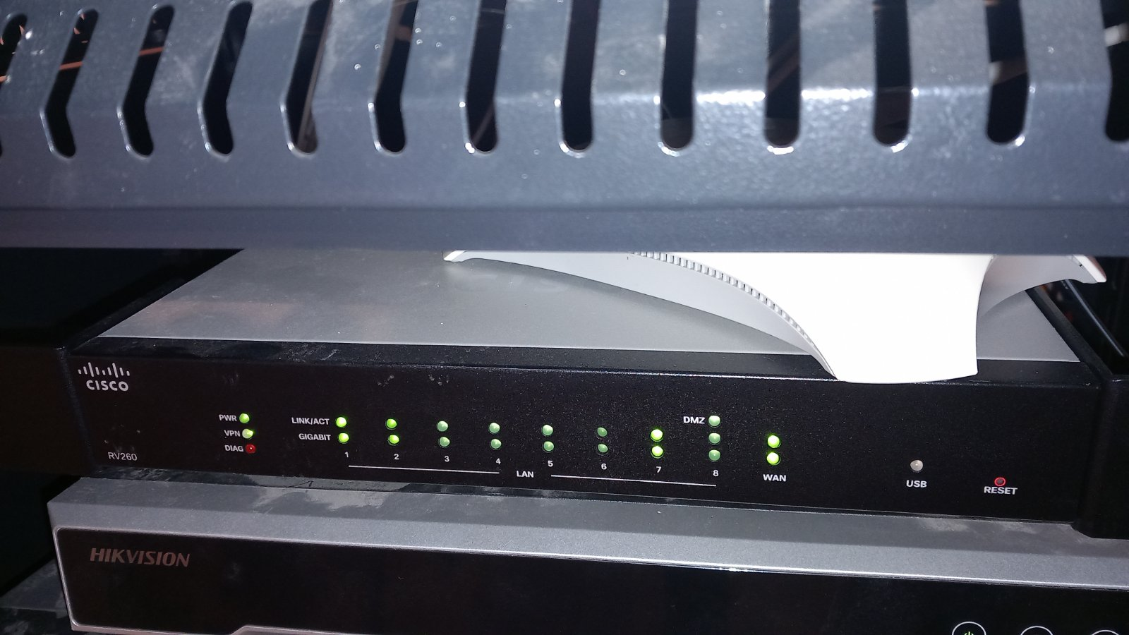

For some time now, I've been experiencing issues with RV260 routers. The problem is that, for unknown reasons, the router freezes/stuck and stops responding to ping and others protocol requests on both the WAN and LAN.
The LED's continue to light up (screen in attachment)
I have the latest firmware installed, which is Firmware Version 1.0.01.10.
Issues related to the ISP and local network do not seem to be the cause, as they are functioning correctly.
The only solution is to restart the device, after which it resumes normal operation.
I have attached the latest router logs (debug mode), which have been sent to the syslog server:
Has anyone else encountered a similar problem with this device? I also have RV340 devices, and they work correctly without any freezing issues.
The issue becomes particularly problematic as I only have remote access to the device through VPN and site-to-site connections. In the event of a freeze / stuck, I lose access to the device and local network.

Unfortunately, none of the above suggestions helped. Today, we had another occurrence. Below the latest collected log from the router:
Wed Feb 14 22:45:51 2024; <13>1 2024-02-14T23:45:51+03:00 mwan3track - - [meta sequenceId="73781"] Interface wan1 (eth0) is offline
It is possible the router has reached the end of it usable lifetime
but there are still some simple actions you can try
1) try to locate another PSU for this device, maybe the problem is originated in the PSU
2) it looks like the device is placed in a data cabinet ?
   -> the router came packed with "ears"/brackets for mounting in a cabinet
   ==>> find those and mount the router to allow air to flow around it
           as it may get to hot sitting on the Hikvision device,
           and there is also a conference mic/phone placed on top of the router?
           else place the router on an separate shelve

Regarding the rack cabinet and the lack of space, as well as the age of the devices, it's not just happening with one device but with several that we own. They are placed in different locations, so I wouldn't necessarily associate these issues with each other.
As for the age, the devices were purchased about 2 years ago, so it would be strange if they started malfunctioning due to their age.
