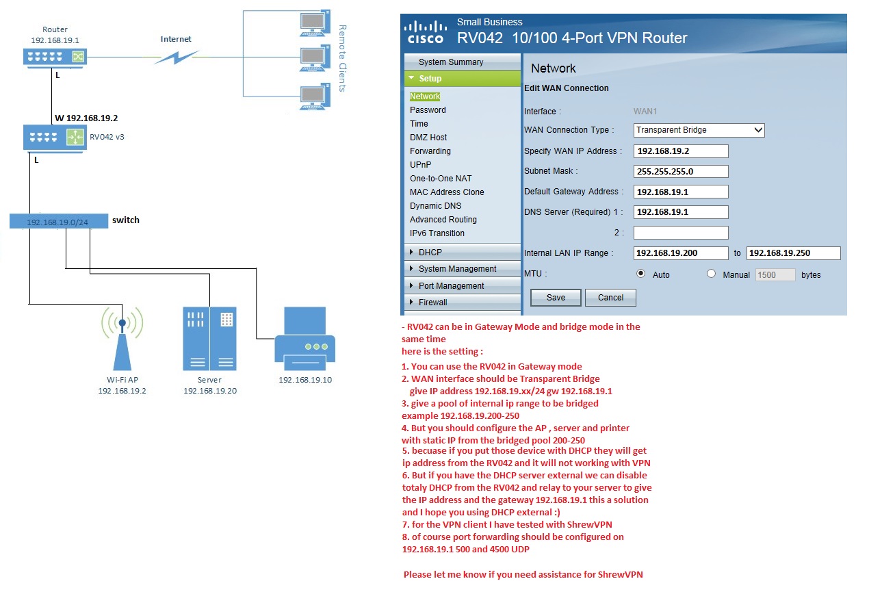

here is a solution:
The RV042v3 can be Gateway Mode and bridge the WAN network at the same time
what I suggest
here is the Topology should be :
here is the setting
1. You can use the RV042 in gateway mode or Router mode (because the gateway for all the host is 192.168.19.1)
2. Wan interface should be Transparent Bridge
     Give IP address 192.168.19.xxx/24 GW 192.168.19.1 (here is screenshot)
4. Give a pool of IP adress to be bridged here as example 192.168.19.200-250
5. But you should configure the AP,Server, Printer with static IP from the bridged pool 192.168.19.200-250 and gateway 192.168.19.1
6. now the problem with Wireless client will not receive an IP address , right ?
7. Disable DHCP server on RV042 and replay to an external DHCP server I beleive you have the server acting as DHCP server and configure it as the bridged network is a solution :)
8. of course we should have a port forwarding 500 and 4500 UDP redirected to 192.168.19.2 (WAN ip of RV042)
9. now moving to VPN setting
here is screenshots from the RV042
of course in advanced setting should enable NAT-T
10. Please if you need any assistance with ShrewVPN let me know.
Thanks and hope I was clear :)
please rate the discussion  or mark as answer to help other cisco customer to get benefit from it
