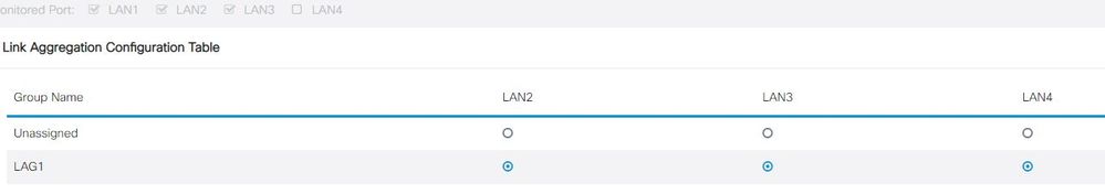

hi
just one clarification please, i was under the impression that the LAG feature on RV34x supports only 2 lan-ports.
does it work with 3 lan-ports?????
thanks
Yes, 3.
nagrajk1969
Thank you so much
