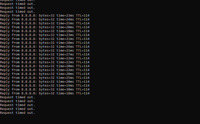

I have the same problem, Port Traffic shows that the connection exists, what is strange I get like 20 seconds of connectivity after initially connecting the cable into the WAN port, after this 20 seconds "Request was time out".
The router-bridge I'm using is also a Huawei but B535-232. With the same configuration Tp-link E605 and my PC works without problem. RV260 gets all the proper IP, mask and gateway. The routing table also seems to be ok.
Diagnostic done on RV260 when trying to ping 1.1.1.1, I get "Network is unreachable" but DNS lookup done on this server work, and addresses resolves correctly. On the other hand nslookup on PC connected to LAN returned DNS request was time out.

08-18-2022 02:55 AM
You need to go to AN->Multi WAN-> Advanced Config and Uncheck "Enable Network Service Detection". After that it started working.

08-19-2022 12:27 AM
Thanks that was the solution to my problem.....
08-19-2022 12:31 AM
this information from you helped
