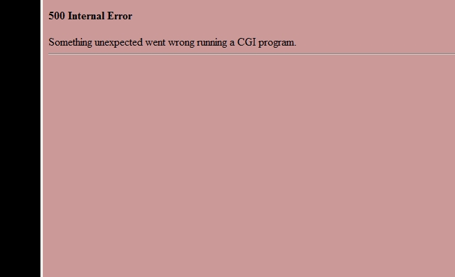

Also, found something else, I were in the GUI earlier, before it died, and then after it died I updated the page and I got this error:
500 Internal Error
Something unexpected went wrong running a CGI program.
I attacted a printscreen of that error as well.
