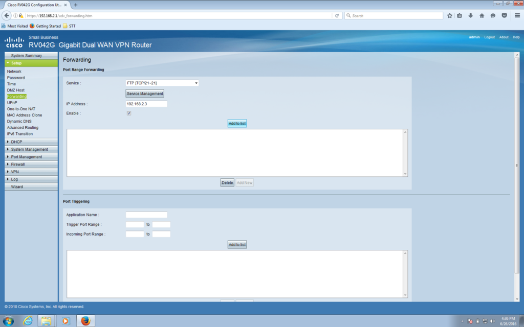

Here are screenshots of Example 1.

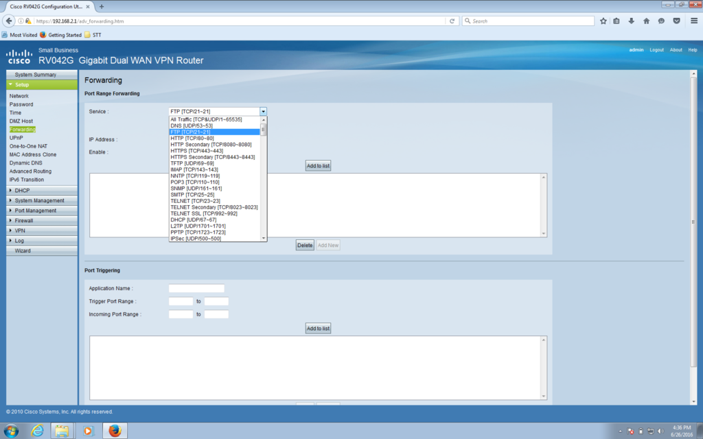

First, I go into Setup>Forwarding, and select a service from the popup menu. It doesn't matter what service I select, the problem happens with ALL OF THEM. Let's try it with FTP as an example:
Screenshot 1
Next, I fill in the local IP address and click the "Add to list" button:
Screenshot 2

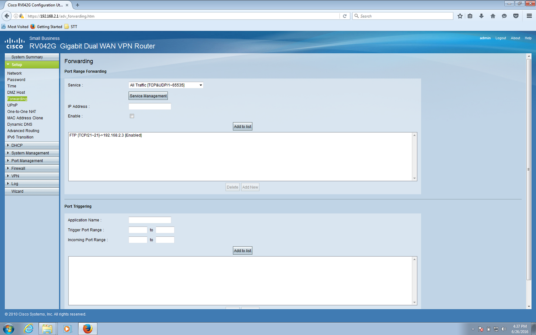

At this point, the service is added to the list and everything seems correct:
Screenshot 3
But now, let's hit the "Save" button. And there is the result:
Screenshot 4
Notice how the service has changed to [ALL/0~0] instead of [FTP/21~21]!!!
What is going on?!?
