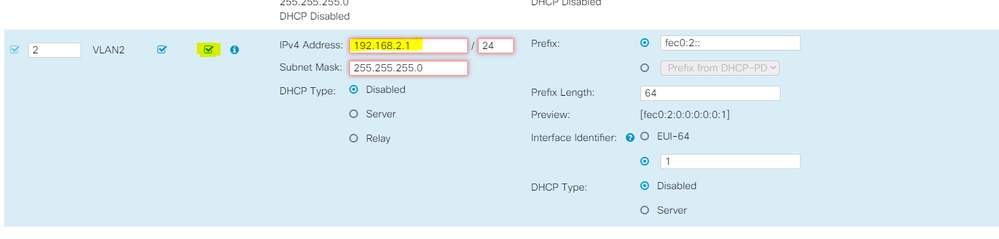

When you create new VLAN, as example VLAN2 with:
192.168.2.1/24
Mask 255.255.255.0
DHCP disable
Device mamagment check box must be enabled.
after this press "Apply" and lose connection. Right?
Now you need connect PC direct to LAN port and change PC ip adress to:
ip: 192.168.2.100
mask: 255.255.255.255.0
Gateway: 192.168.2.1
And reconnect to router with new router IP: 192.168.2.1
After connect you need to save settings in running config
