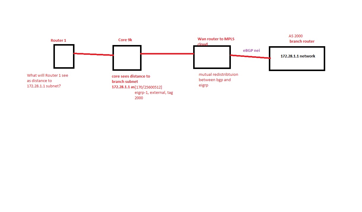

Hello everyone,  I have a 2 part question that I will try to put as much context into as I can.
Lets say I have a Core Nexus 9k multi-layer switch/router that sees a route, lets say 172.28.1.1 as distance  [170/25600512]  eigrp-1, external, tag 2000 to get there.  Now let say I connected up a router (Router1) to this 9k via a routed link they becom eigrp neighbors with eachother.  Now Router 1 is 1 hop farther away from the 172.28.1.1 network.  I'm wondering will Router1 see the metrics as the exact same as the core 9k sees it [170/25600512] ?  or will EIGRP metrics know that this route is farther away, so it will change the metrics to something higher than 25600512.  I'm pretty sure the AD won't change because it will still view this route EIGRP external routes, but I'm wondering if the metrics will change.   the  Picture attached describes the situation better.
So in a nutshell, my question is pretty much just asking does hops become a factor in changing EIGRP metrics when we're increasing hops such as my example?

If Router1 is learning that route from N9k, it will do a metric calculation based on the  metric values that N9k advertises to Router1. So there will be an increase in metric in Router1.
If you do a packet capture, you can see the route update like this:

yes, that is correct, it is learning it from the n9k because that's the only path it has to get anywhere...as of now.  Thank you for answering my question.  So the metrics will increase.  The second we provision Router1, I will do a sh ip route and see if the metrics have increased indeed.

I just read through the discussion again and see a question in the original post that we have not really addressed. The question was "So in a nutshell, my question is pretty much just asking does hops become a factor in changing EIGRP metrics when we're increasing hops such as my example?" The question becomes more interesting in the context of the response which has capture information about an EIGRP advertisement. That output clearly shows that hop count is included in the advertisement. So it would be easy to assume that hop count is used to calculate the metric.
But that is not correct. Hop count is not used in the calculation of the metric. EIGRP does track the hop count. And EIGRP does have a limitation on the maximum number of hop allowed (which is why it is in the advertisement). But EIGRP does not use hop count in calculation of the metric.
But hops does indirectly become a factor in the calculation of the EIGRP metric. One part of the calculation is delay. And we should remember that delay is accumulated over the entire path. So every time we go another hop we add a bit more delay in the metric, and the metric does increase every time we go another hop.

yes correct! I re-read more until I figured out how that works.  Not hope count, but the delay will make the metrics heavier and since it has to do more hops, means more delay will be added.  so if I had been more knowledgable of delay before posting this question, I would've rephrased it...or maybe never asked it. :)

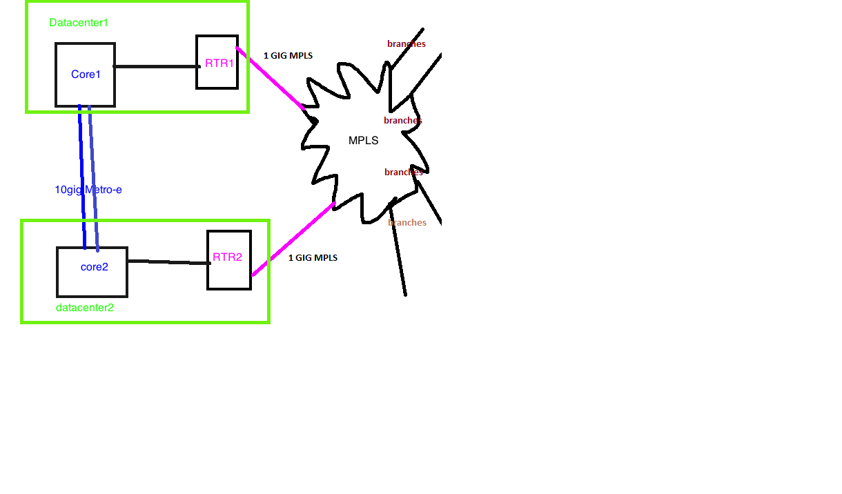

yep that answered it.  What I was asking was the latter part of your statement: so there is a loop now, but once the primary path fails, there will no longer be a loop in the network for that secondary path...so it will become primary.  Thank you for clarifying.
environment in a nutshell:
2 datacenters geographically separated.  Both have a WAN router that does eBGP with ISP MPLS router (1 gig circuits) which in turn connects to all our branches.  These WAN routers also do EIGRP with its corresponding core n9k.  Mutual redistribution happens on the 2 these WAN routers with no filtering - meaning that BGP and EIGRP will share everything fully from one to another.  Picture attached will make it very clear.   Datacenter 1 has default information originate on the BGP confis so the branches use this is at the primary gateway for getting out to internet for example since all routes have to come back to datacenter anyways to leave.  The cores see the branch routes as AD 170 eigrp external routes learnt from redistribution.  We are now thinking of connecting up a 10gig metro-e circuit directly from core to core between these 2 datacenters which in turn makes the network into 1 big loop.  The questions I asked were related to this topology.  so what I'm presuming now is that once we connect up this metro circuit, the cores will see 2 ways of getting to the branches now, 1 through the normal route directly through the WAN router and 1 through the other core.  So I'm just thinking of how EIGRP will react to something like this.
