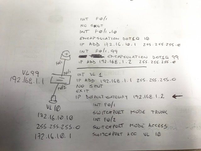

Hello i have an issue where i have a PC with a vlan 10 and and IP address 172.16.10.10 on it and a switch where there is a vlan 99 on it with an IP address 192.168.1.1 and a router for intervlan, the switch is a layer 2 switch, when i ping the vlan 99 from my PC it gives me destination host unreachable, what should i do to have a successful ping.
Hi @alaahijazi
Draw a small diagram and point to the command:
S(config)# ip default-gateway <gateway ip>9E5BD6DB-43F4-42F5-883D-2E67075EBD50.jpeg

hello, i think im missing this one : The switch must have the correct gateway configured
how should configure it
Hi @alaahijazi
Regards
You are the Best thank you !
