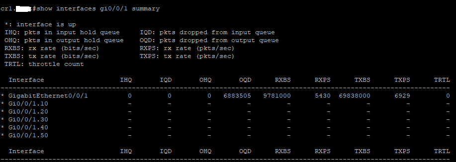

beforeclearcounters19.PNGinterfacebeofreclearing.PNGpktsdroppedfromoutputqueue.PNGwiresharkcapture.PNG
After reading some forums i have suspect that service policy was causing the issue and i have delete the service policy to see if it has any effect and after remove service policy from the router interface the output drop and packet dropped from output queue stopped.but i did another wireshark capture and we are still experience high number of retransmission and duplicate ack

you have removed the output drops on the router ASR 1000 gi0/0/1 by removing the application of the policy map using

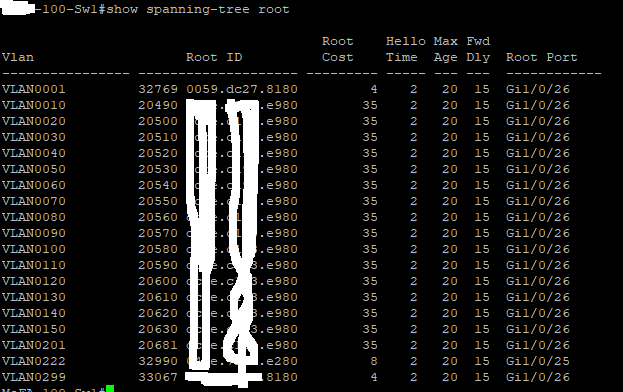

Hello Abdullah,
from the output that you have provided we can see the following:
the first switch near the router is NOT the root bridge for all the existing Vlans for example it is not for Vlan 1, Vlan 222, Vlan225.
You can easily verify on the following screen captures from other switches:
the root cost and root bridge priority is different for Vlan1 and Vlan222.
The last switch MoTR-120-Sw is the root bridge for Vlan 222 as it reports cost 0 and no root port is listed.
As I have explained before in a ring topology the placement of the root bridge for each Vlan needs to be carefully planned.
About the user port it is working 10 Mbps full duplex but it shows some collisions and late collisions so check if the device on the other side of the link is working 10 Mbps full duplex.
Also the port is in what Vlan ?
You should also look at the interfaces on the path between the client and the router interface.
Hope to help
Giuseppe

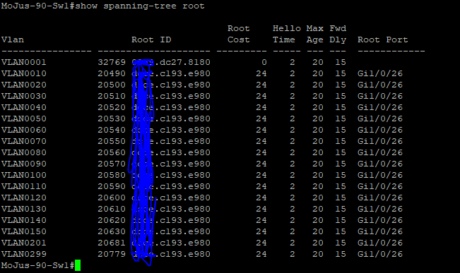

Hi Giuseppe sorry for the late reply i have been out of work for personal reason.
while i was away my colleagues tried to resolve the issue but with no success.
i have remove vlan 222 because nobody was using the vlan and it had different root bridge than the other vlans
Now all Switches agreed the Switch in NOC is root bridge except vlan 1 it has different root bridge but Note we don't use vlan 1 even as NATIVE vlan.so i am not sure if it can use problem.
All Switches agreed in Root Bridge
I have also checked all interconnect links and other is no any indication of interface error
All switches have different root bridge for VLAN 1(we don't use vlan 1 as native vlan) this switch is the root bridge for vlan 1

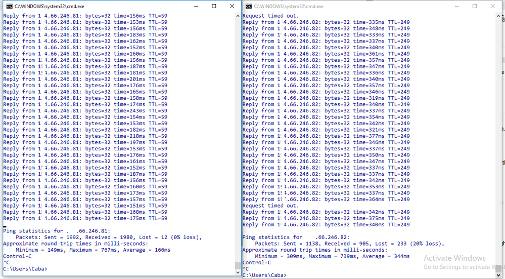

I have hunch where the problem is but i want to be sure before i report to Up stream provider
i have been pinging our routers, one is in the NOC and the other one is at Upstream provider facility we have fiber connection between the ASR 1001 routers.i have notice ping all three routers(our two asr 1001 and upstream router aka our gateway router ) there is more than 20% packet loss when we ping the Upstream provider router
66.246.82 is one our router in Upstream provider 66.246.81 is the Upstream router
I have also pinged from from my home(i use different ISP ) and the result is almost identical
and these consistent it's not one off.
and lastly i have downloaded pingplotter(someone recommended ) and i think this demonstrate where the problem is perfectly
Also Wireshark capture shows 40% Bad TCP(retransmission and duplicate ack)
After all the evident can i conclude that the problem is the at router of our Upstream Provider not Local one
I appreciate the help

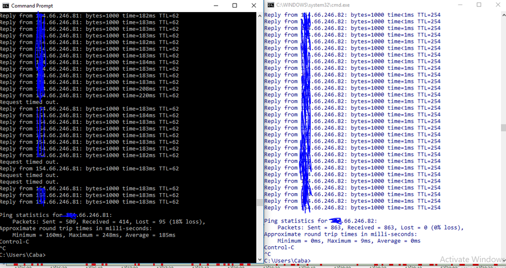

Thank Giuseppe for prompt response
I have increase the packet of the ping to 1000byte and result seems same we are still experience around 20% packet loss
Is this mean that it not the  ICMP policy limiting the ping and there is other issues.???
Also we should have one STM-1(155mbps) bandwidth but we are averaging 70-80mbps even though i have remove bandwidth shaper from our router internet experience is very slow.
Highly appreciate the help.
