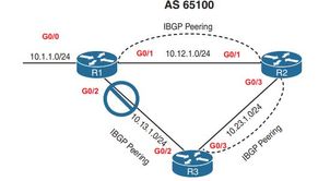

I have a three-router topology with all iBGP sessions in the Established state. A PC (10.1.1.100) is attached to R1's G0/0. The  Topology.JPG
link between R1 and R2 is also up. Pings from R2 and R3 to 10.1.1.1 (R1 G0/0) are successful but pings from R2 and R3 to the PC are unsuccessful. Any idea why? Thanks in advance.

ok instead of ping use traceroute, let see when the ICMP is stop from there we will start troubleshooting.

first there is split horizon loop prevent in iBGP
so R1 must advertise the prefix into R2 and R3 BUT the
next-hop
is R1,
R3 never advertise the prefix to R2 even if R2-R1 is link is down,
what you need is
run ospf
between the three routers, and then
redistribute BGP into OSPF
this solve your issue.
Thank you for the reply.
If you take a look at R3's BGP table, you will see that 10.1.1.0 has an
entry for 10.1.1.0 with a best past next hop on R1. I may be mistaken but
doesn't this mean that 10.1.1.0 was advertised to R3? I also stated that
the link between R1 and R2 is up but I forgot to mention that I have full
mesh iBGP configured on these three routers. The PC is also configured with
its default gateway to R1.
I did it before but here are the screenshots. They show and thank you for
your suggestions, that R1 is where it stops. That gave me the idea to try a
redistribute connected
on R1 but that didn't help.
in R1 is stop,
then as @Harold Ritter suggest,
if you emulate router to be as PC then you need
ip defualt-gateway
no ip routing
It looks like you both are correct; it doesn't seem to be a BGP problem
after all. I am trying another simulation with the default gateway
command I was using until now for Alpine Desktops on CML. I know that at
some point it was working.
usually I use emulate router to be PC,
and this give me some advance like debug and show L2 counter.
anyway
glad your issue is solved.

Hi @NBenat ,
It looks like you might be missing a default gateway setting on the PC. It should be set to 10.1.1.1.
Regards,
Regards,
Hello Harold,
Thank you for your reply. The gateway was set and pings fine to the router.
Hi @NBenat ,
Since R3 could ping R1 (10.1.1.1), but not the PC (10.1.1.100), it looked like the PC might not have a default gateway. What is the PC? Is it possible that it has a host based FW and that is does not allow the ping from R3?
