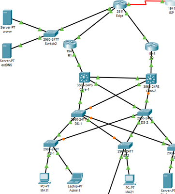

I'm currently working with a network setup in Packet Tracer and facing issues with pinging a web server. Here are the details of my configuration:
I have a web server with a local IP of 172.25.31.2/29 located in the DMZ Zone. To facilitate communication, I added a static NAT entry using the command: "ip nat inside source static 172.25.31.2 209.165.112.254".
For the clients, such as MA11 (172.25.30.70/26), I've set up NAT with overloading using the following commands and
I've also configured relevant static routes and access control lists (ACL) for NAT:
ip nat inside source list ACL_NAT interface Serial1/0/0 overload
ip nat inside source static 172.25.31.3 209.165.112.253
ip route 0.0.0.0 0.0.0.0 Serial1/0/0
ip route 172.25.30.64 255.255.255.192 172.25.31.10
ip route 172.25.31.8 255.255.255.248 172.25.31.10
ip access-list standard ACL_NAT
permit 172.25.30.0 0.0.0.63
permit 172.25.30.64 0.0.0.63
permit 172.25.31.8 0.0.0.7
The address of R1 on Gig0/1 is 172.25.31.10/29. The problem arises when I try to ping the web server (209.165.112.254) from the client. The ping request reaches the web server, but on the return path, it fails at the edge router. I've checked the NAT translation table using the command show ip nat translations, and here is the output:"

It seems the response from the web server is not reaching the client through the edge router. I've attached the full configuration of the edge router for reference.
PS: On R1 HSRP is enabled.
Any insights or suggestions on resolving this issue would be greatly appreciated.
