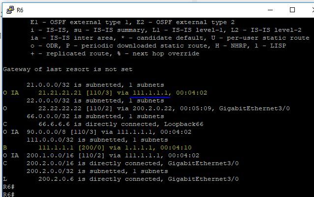

if you look at my below output, there is an inter-area route "O IA 21.21.21.21 [110/3] via 1.1.1.1, 00:08:21"
says 1.1.1.1 as next-hop but OSPF process 2 has no knowledge about 1.1.1.1
1.1.1.1  is actually included in the OSPF process 1.

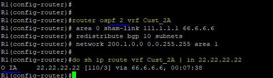

whereas output in R1 is having expected next-hp (source of sham link session)

R1 is installing OSPF route, please note the OIA notation for the customer route(22.22.22.22/32)
I believe OSPF routes are installed because of the lowest AD (110 < 200)

Not sure what happened, I have done nothing just restarted my gns3 topology, now I'm getting the same behavior on both sides.
