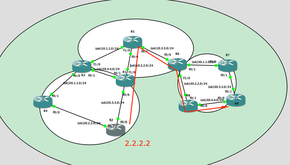

Hi Guys!
How to prioritize route 2.2.2.2 thru R8? Does it possible to match some policy and to put better metric then it now? For current situation for 2.2.2.2 it's multipath coming from R8 and R7 with OSPF metric 6.
But if I set maximum path to 1, it comes from R7. So I want exactly 2.2.2.2 from R8 and everything else no matter, let it go from R7 or R8 independenly. If I play with ip ospf cost on interface it will make all paths comes from prioritezed router. So I need something like policy, to match exactly route and set ospf cost to it. Does it possible?

Sorry that did't draw clearly, but there are 3 areas. With area 0 in the middle, also thera OSPF only.
So Yes, I did research and there are PBR solution only. Worked for me on that LAB.

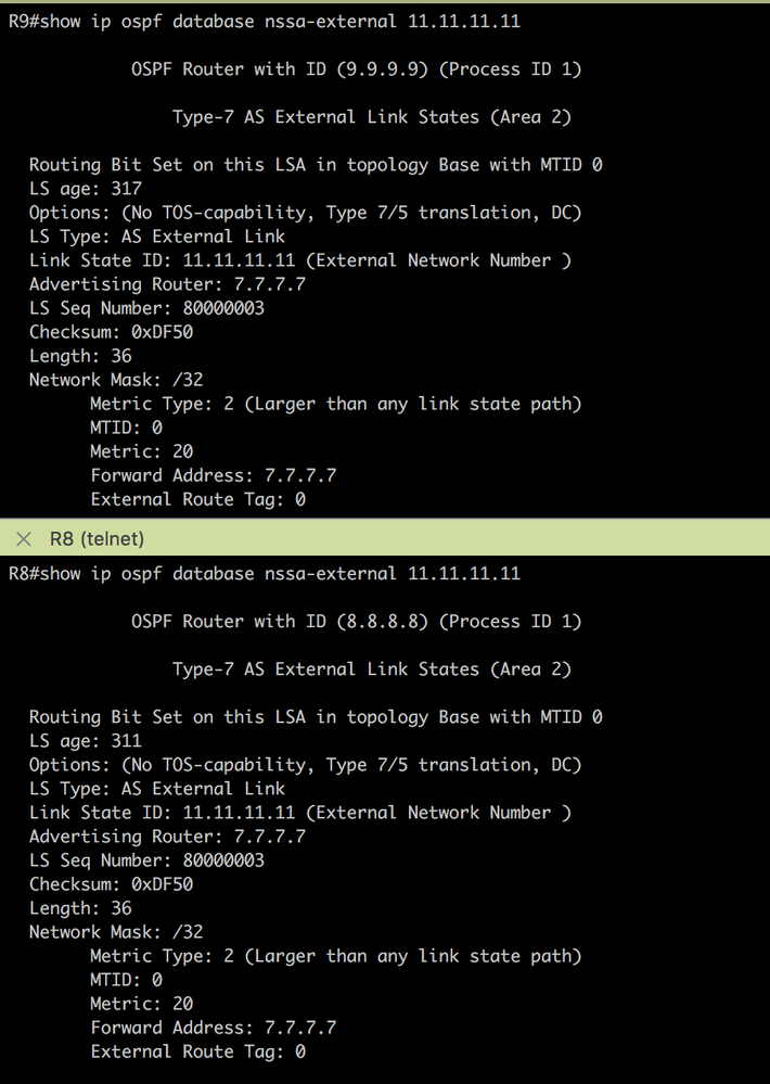

@Timohamoto - Basically you're right, the router-id is the tie break, but I think there are some exceptions.
Can I see an output of the on R7:
show ip ospf neighbors
show ip route ospf (with 1 path and 2 paths)
I want to see how is the prefix known to OSPF.

So there are NSSA in Area2. Here is what we have from two possible ways thru R6 and R9. And what is makes preferable R6... 😞 I did try to change R9 to ID less than R6's 6.6.6.6 but it's still went thru R6.

When you changed router-id on R9, did you cleared the ospf process? If so, did you do it on R9 and R8?

@Calin C.@Francesco Molino
Finally Highest router ID makes priority. Thank you guys
(@Calin C. not lowest how I wrote you in private message 😐 some confusion there)
Yeah that's right, Higher router-id makes priority. I didn't noticed you were talking about lower and on your print-screens, R9 have a higher RID.
