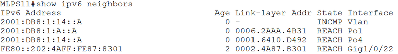

This is the problem im facing, the packet with source from PC0 tries to send an echo message to PC1 with the corret destination IPv6 address but the packet in MPLS11 gets discarted to create an NDP message even if the destination MAC address is already added to the neighbours table.

Neighbours Table:
