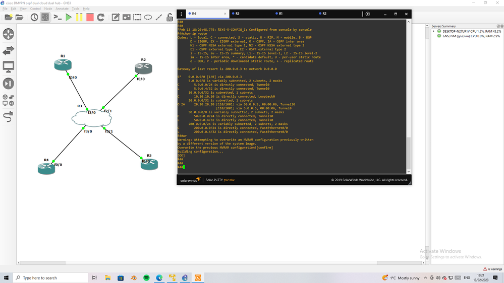

I run lab and full success,
please check the attachment photo,
if you need more detail or you want something specific in lab please ask.
thanks
MHM
