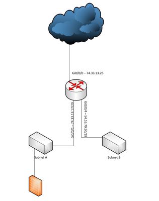

Hi Richard,
I'll attach a pic to hopefully clear things up a little bit more. IPs have been changed to protect the innocent. As for NAT translation that is done by an ASA firewall that sits off the first subnet.
Matt
Thanks for the diagram, which is helpful. Am I correct in understanding that the mask for the G0/0/0 is /30. If not what is it?
Also am I correct in understanding that originally the ISP gave you 2 Public address blocks (a /30 as a transit subnet and a /29 for use by devices in your internal network)? And correct in understanding that the same ISP has now given you a second /29 of Public IPs? If not what is correct?
Also, do you have devices connected in subnet B using the new IP addresses? If so does their default gateway point to the address of G0/0/4?
Also are there any security policies, acls, etc on G0/0/0 checking traffic coming in from the Internet?

Richard,
Correct, the mask for Gi0/0/0 is a /30 and correct the /30 for transit and the /29 for my devices. And also correct I have a new /29 from the ISP.
I do have a device on the new subnet and the default gateway is the IP from gi0/0/4. I can route internally from that subnet to the old subnet but not out to the internet.
No security policies in place
Matt
