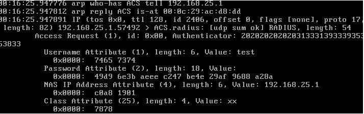

    Packet from Client to ACS
    Packet from 25.1(CLIENT) to ACS
    Packet from ACS to Radius Server
    Now, This is the same packet going from ACS to 65.5(radius Server)
    This shows that ACS does not interfere with the packet content, it proxies it as it is.

    Packet Capture Output
    I got a packet capture and here is the answer:
    25.1-client
    25.5-ACS
    65.5-External radius Server
    I got it on the same capture as I was using a VM interface.

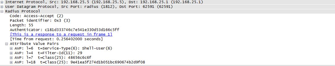

    Packet capture - ACS to User
    Now here is what ACS sent back to the User:
    You can see that it stripped the proxy attribute as proxy ended on the ACS, it forwarded the rest of that packet as it is.
