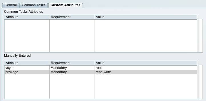

The advice is to add it to the group as follows:
ervice = netscreen {
vsys = root
privilege = read-write
This problem can be fixed by making different device groups and shell profiles mapped to different authorization profiles.

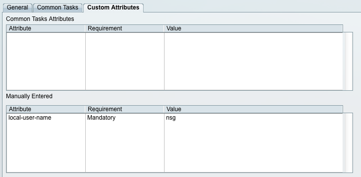

Setup for juniper:
Step 1:
Step 2:
