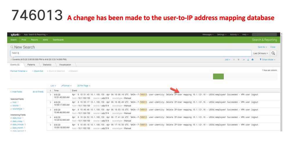

746012
Error Message %ASA-5-746012: user-identity: Add IP-User mapping IP Address - domain_name \user_name result - reason
Explanation A new user-IP mapping has been added to the user-to-IP address mapping database. The status of the operation (success or failure) is indicated. The success reason is VPN user. The failure reasons include the following: Maximum user limit reached and Duplicated address.
Recommended Action None required.

746013
Error Message %ASA-5-746013: user-identity: Delete IP-User mapping IP Address - domain_name \user_name result - reason
Explanation A change has been made to the user-to-IP address mapping database. The status of the operation (success or failure) is indicated. The success reasons include the following: Inactive timeout, NetBIOS probing failed, PIP notification, VPN user logout, Cut-through-proxy user logout, and MAC address mismatch. The failure reason is PIP notification.

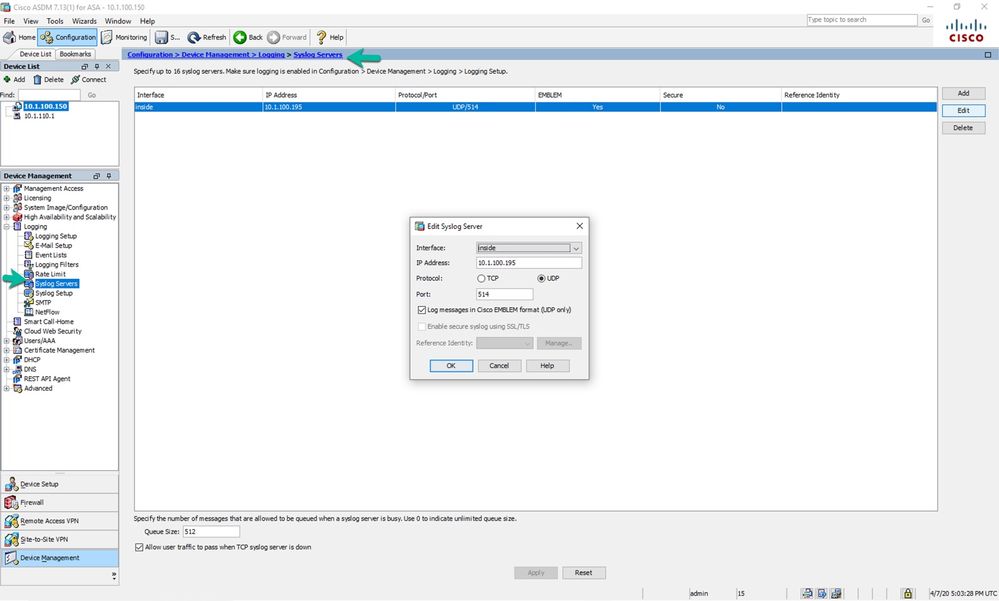

  1. Define the Syslog Server
a   Configuration > Device Management > Logging > Syslog Servers

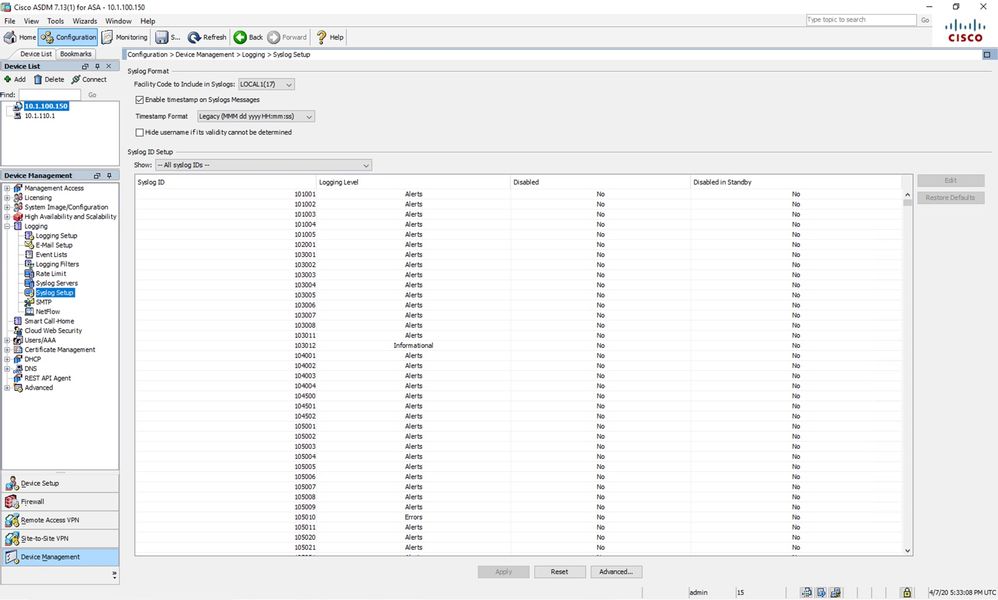

2.  Syslog Setup
a. Configuration > Device Management > Logging > Syslog Setup
Choose a system log facility for syslog servers to use as a basis to file messages. The default is LOCAL(4)20, which is what most UNIX systems expect. However, because your network devices share eight available facilities, you might need to change this value for system logs.  Source:  ASDM Online Help.
Note:  In this example. LOCAL1(17) is being used.

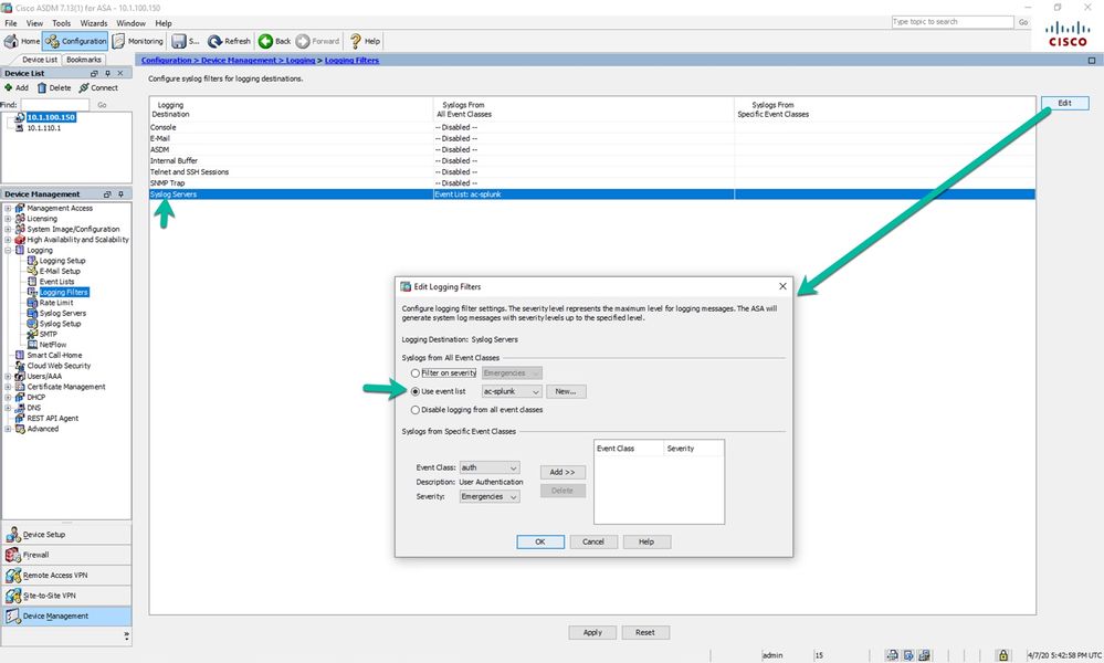

4. Add the Event List to the Logging filter for Syslog
a. Configuration > Device Management > Logging > Logging Filters
