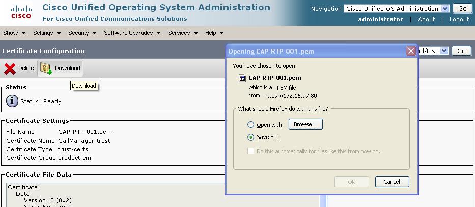

6. Now that the CallManager has the ASA's certificate in its trust list, we'll need to export some or all of the following items from the CallManager to import them back to the firewall later on:
  • Cluster CTL file (only if some of the remote phones use LSCs -- refer to step 6a)
  • Cisco_Manufacturing_CA, CAP-RTP-001, and CAP-RTP-002 trust certificates as well as CallManager indentity certificate (only if some of the remote phones use MICs -- refer to step 6b).

b. Perform this sub step only if you plan to use MICs on some of the remote phones connecting through Phone Proxy. Bear in mind that if a remote phone has an LSC installed, it will have priority over MIC. Otherwise, skip to step 7.
Under the same "Security -> Security Management" screen on the CallManager interface, click "Find" button on the "Certificate List" page to display all of the certificates used by the CallManager. As indicated above, you need to export the following File Names under "CallManager-trust" Certificate Name:
  • CAP-RTP-001
  • CAP-RTP-002
You would also need to export the following File Name under "CallManager" Certificate Name:
  • CallManager
For each of the certificates circled above, click on the corresponding link and download it as a PEM file:
At this point, we're done with the CallManager side of the configuration, so you can log out of the interface and move back to the firewall.

8. Now that all of the certificate information has been exchanged between the CallManager and the firewall, we can proceed to configuring the actual Phone Proxy feature. First, we will create a CTL file instance to be used by Phone Proxy.

9. Perform this step only if some remote phones will be using LSCs to connect through Phone Proxy. If so, make sure you had followed substeps 6a, 7a and 8a. If none of the remote phones will have LSCs installed, skip to step 10.
In this step, we'll need to create an entry for the CallManager CAPF certificate under the Phone Proxy CTL file configuration section. This will allow the firewall to correctly authenticate LSC-provisioned phones for both signaling and media sessions as well as facilitate new LSC provisioning for remote phones. We can reference the CAPF certificate from the CallManager cluster's CTL file that had already been imported to the ASA. First, we will issue the following command to determine the internal reference name:
phone-proxy(config)# show run crypto ca trustpoint | include CAPF
crypto ca trustpoint _internal_CTL_phone-proxy-ctl_cn=CAPF-da010b7e;ou=SJ-CUCM;o=Cisc
Now, we'll create the CAPF record under the CTL file configuration (we'll have to shut down the instance first):
phone-proxy(config)#ctl-file phone-proxy-ctl
phone-proxy(config-ctl-file)#shutdown
phone-proxy(config-ctl-file)#record-entry capf trustpoint _internal_CTL_phone-proxy-ctl_cn=CAPF-da010b7e;ou=SJ-CUCM;o=Cisc address 192.0.2.100
phone-proxy(config-ctl-file)#no shutdown
