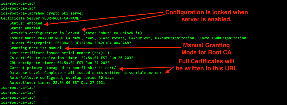

Validate the Root CA
We want to see that the CA server is enabled.
show crypto pki server
show crypto pki certificates verbose YOUR-ROOT-CA-NAME
show ip http server session-module
The configuration on the Root CA is complete.   It's now time to move on and configure the other router.

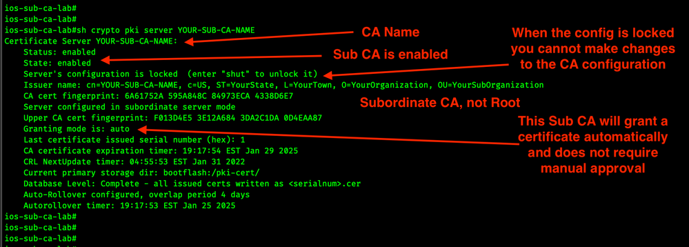

Before we grant the request on the Root CA, let's quickly look at the Sub CA status.
Now that we see the Subordinate CA status is pending let's move on to granting the certificate request.

Now let's validate that the Subordinate CA is running.
show crypto pki server YOUR-SUB-CA-NAME
Congratulations!     You now have a working Root & Subordinate Certificate Authority.
