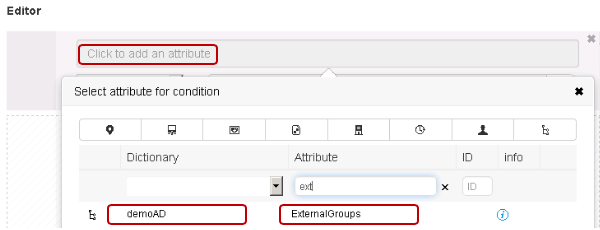

  • You can use attributes from Active directory for authorization that are sent to network devices.
  • You could rewrite incoming usernames.
  • Optimize the behavior of how ISE tries to talk to Active Directory (From ISE UI: Administration => Identity Management => External Identity Sources => Active Directory, go to your AD entry and go to Advanced settings tab).

Using External Identity Sources for User identities
In this document we are using Active Directory (AD) as an External Identity Source. So you need to add the Active directory domain as a join point in ISE. ISE supports one or more AD domains and forests. It allows up to 50 Active directory join points across your AD domains and forests. A join point is simply the point where you join the AD domain.
If you have multiple domains across different businesses and want to authenticate based on separate AD join points turn on the scope mode. This is a less known feature but useful in situations where you need to use single or multiple join points in an authentication policy as authentication results. When you enter scope mode, ISE creates a container called initial scope and allows you to create multiple scopes.
In the section earlier, I discussed about AD benefits, one of that is it allows you to allow-list the authentication domains you want the user to authenticate against. This optimizes performance. When users authenticate, it is highly recommended to use fully qualified names (that is, names with domain markup e.g.: UPN: [email protected], NETBIOS: ACME\jdoe or FQDN DNS: host/machine.example.com) for users and hosts during authentication.
Adding Active Directory join point
  1. To add an AD join point, browse to Work Centers > Device Administration > External Id Sources > Active Directory. Click Add to define a new AD Joint Point. Specify the Join Point name and the AD domain name and click Submit.
  2. If the status shows Not Joined, click the checkbox next to ISE node and click Join.
  3. In Join Domain pop-up window, fill in the Active Directory administrator username and password.
  4. Click OK to start the join operation. A window Join Operation Status will pop up. Wait until the node status turns Completed, and then click Close.
  5. The Connection tab will show ad.securitydemo.net as the domain controller and Default-First-Site-Name as the site.
  6. Step 10 Click on the tab [ Groups ] and look at the list of AD groups. The groups we will use in the document are Contractors, Employees, and Staff, and map to TACACS+ authorization policy rules such that. This is to give an example of the AD groups that you can map to a role.
    Staff => Network Admin
    Employees => Security Admin
    Contractors => HelpDesk
As Staff is also member of Employees, we will arrange the Admin rules higher in priority. Create the groups as needed in Active Directory for this.

  1. Define the Authorization Policy by clicking the Authorization Policy option in the Policy sets => Set view screen. Here we define the authorization policy based on the user groups in Active directory.
  2. The steps to create a new Policy set, authentication and authorization policy are the same. Create the authorization rule by clicking +, then add the conditions that the authorization policy should satisfy. After that, you need to add the result when these conditions match by choosing the right Command Sets and Shell profile.
  3. Here are steps to add conditions to Authorization policy just in case you need help. From the Conditions studio right panel Click to add an attribute as shown in screenshot below.
  4. Select the Dictionary, in this case we are using the AD join point (e.g:demoAD) and “External Groups” attribute available in the list. You can use the filters for this too as shown above.
  5. Select the right operator from the drop down window. Choose the value as in the table above.
    Note: When you have special characters in the value make sure to test this against the values received from the Network Device
  6. Click Submit to save the policy set.

  2. Create the Authentication Policy. For Authentication, we will be using the Active Directory (demoAD) as the ID Store.
  3. Define the Authorization Policy. Here we will be defining the authorization policy based on the users Group in Active Directory and the location of the user. For example, the users in Active Directory group in each location can access only the devices located in that region whereas other admin users cannot.
    Status Rule Name Conditions Shell Profiles
    ✓ WLC HelpDesk Europe demoAD:ExternalGroups EQUALS demo.local/HCC/Groups/HelpDesk
    AND
    demoAD:ExternalGroups EQUALS demo.local/HCC/location/Germany
    WLC_Monitor_Only
    ✓ WLC Security SA demoAD:ExternalGroups EQUALS demo.local/HCC /Groups/Security_Operators
    AND
    demoAD:ExternalGroups EQUALS demo.local/HCC /location/SouthAfrica
    WLC_Security_Access
    ✓ WLC Admin APAC demoAD:ExternalGroups EQUALS demo.local/HCC /Groups/Network_Operators
    AND
    demoAD:ExternalGroups EQUALS demo.local/HCC /location/APAC
    WLC_Admin
    ✓ Default
    DenyAllCommands
This completes the policy configuration in ISE.

  3. Define the Authorization Policy. Here we define the authorization policy based on the user groups in AD and the location of the device. For example, the users in AD group Germany can access only the devices located in Germany.
    ✓ NX-OS HelpDesk Europe demoAD:ExternalGroups EQUALS demo.local/HCC/Groups/HelpDesk
    AND
    NX-OS_Helpdesk
    ✓ NX-OS Security SA demoAD:ExternalGroups EQUALS demo.local/HCC /Groups/Security_Operators
    AND
    NX-OS_Security
    ✓ NX-OS Admin APAC demoAD:ExternalGroups EQUALS demo.local/HCC /Groups/Network_Operators
    AND
    NX-OS_NetworkAdmin
    ✓ Default
    DenyAllCommands

  3. Define the Authorization Policy. ASDM access is governed by the three pre-defined privilege levels so we will give Permit_All_Commands to all authenticated administrators for simplicity.
    Status Rule Name Conditions Command Sets Shell Profiles
    ✓ ASA HelpDesk Europe demoAD:ExternalGroups EQUALS demo.local/HCC/Groups/HelpDesk
    AND
    ASA_Basic
    AND
    HelpDesk
    _Commands
    ASA Monitor Only
    ✓ ASA Security SA demoAD:ExternalGroups EQUALS demo.local/HCC /Groups/Security_Operators
    AND
    Permit_All_Commands ASA Admin
    ✓ ASA Admin APAC demoAD:ExternalGroups EQUALS demo.local/HCC /Groups/Network_Operators
    AND
    ASA_Basic
    AND
    Helpdesk_Commands
    AND
    ASA_ReadOnly_extra
    ASA Read Only
    ✓ Default if no matches, then
    DenyAllCommands
ASA CLI Access
    Status Rule Name
    Conditions
    ✓ Admin
    demoAD:ExternalGroups EQUALS demo.local/HCC/Groups/Network_operators
      piSuperUsers
    ✓ HelpDesk
    demoAD:ExternalGroups EQUALS demo.local/HCC/Groups/Helpdesk
      piSysMon
    Deny All Shell Profile
  4. Click Submit to save the policy set.
