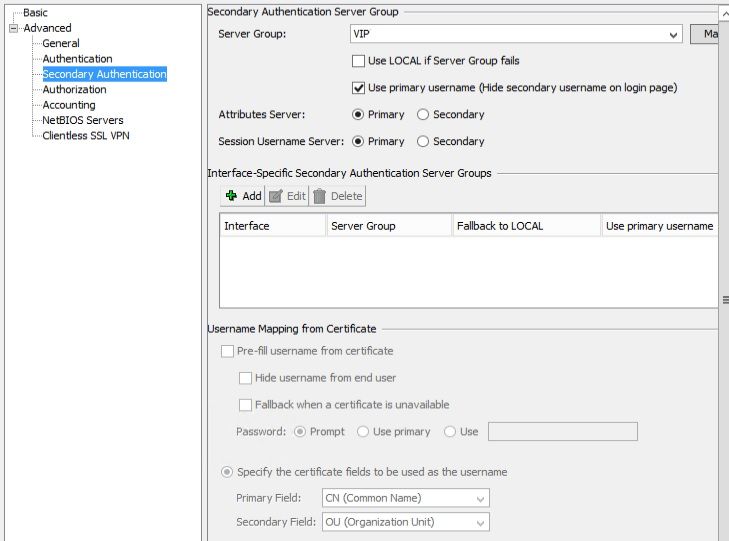

Because 2FA, uses two authentication sources, as the name suggest, you will also need to add a secondary authentication method, this time I have used a server group called VIP (using Symantec's VIP service).
If you are using Symantec or any 3rd party 2FA provider, such as through MS Azure, then you can decide to point your secondary AAA server to either an on premise 2FA gateway or a cloud thingy. Either way, from an ASA point of view you will need a different IP address. Typically, you will connect on ports tcp/1812 for authentication and tcp/1813 for accounting.
