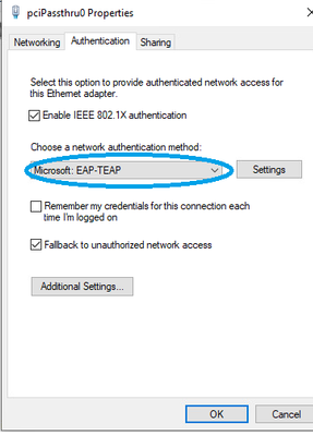

1. Login to domain joined machine that will be used to generated the XML and ensure the defined options above have been enabled/imported
2. Under the Authentication tab on the Network Adapter properties set the Choose a network authentication drop down to Microsoft EAP-TEAP.
3.Click the Settings button next to the drop down

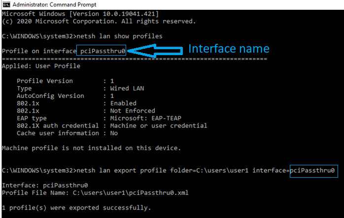

6. Open a command prompt as administrator and execute the following commands:
netsh lan show profiles - Note down the interface name
netsh lan export profile folder=PATH_TO_FOLDER interface="INTERFACE_NAME"6.png
An XML file will be generated with the required TEAP configuration. The interface name will be the name of the file in the location path set.

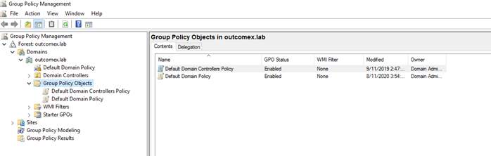

2. Right click on the domain and select Create a GPO in this domain, and link it here
Name the new GPO

2. Navigate to the wired network adapter under Authentication and you will see Microsoft: EAP-TEAP is selected as the authentication method. If you navigate around the rest of the Authentication settings will match what was created via the XML.eaps.png

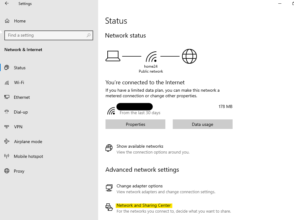

I found the solution:
Actually the problem is that Microsoft is still divided between their new UI introduced with Windows 10 and the older UI that came with Vista/7/8.
to find EAP-TEAP settings for a manual configuration you need to Open Network & Internet settings
Select Network and sharing center
Set up a new connection or network
And after, selecting to connect to a wireless network it offers also TEAP security options with WPA2-Enterprise

You are correct it not straight forward with the new UI. See my screen capture as one way to do it.
