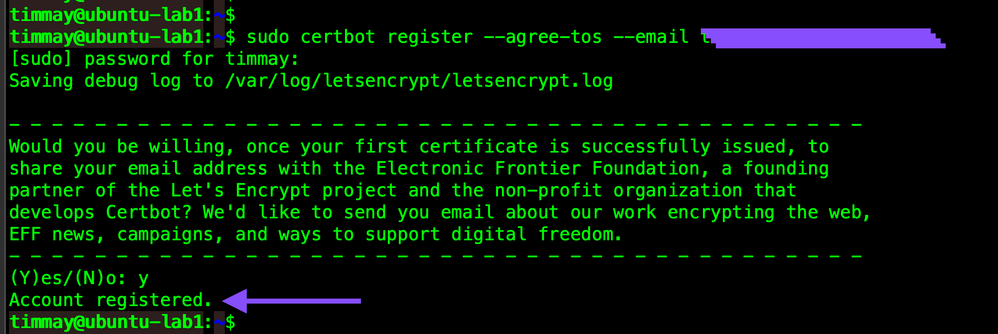

Let's Encrypt Registration
NOTE: Typically all Certbot commands must be run with sudo. There are ways to work around this but that is for a different discussion.
In order to use Certbot you must first register with Lets Encrypt.
In my experience, you won't receive a confirmation email. The only time I've received emails is when a certificate is close to expiring.
sudo certbot register --agree-tos --email your-email-address@ourdomain.net

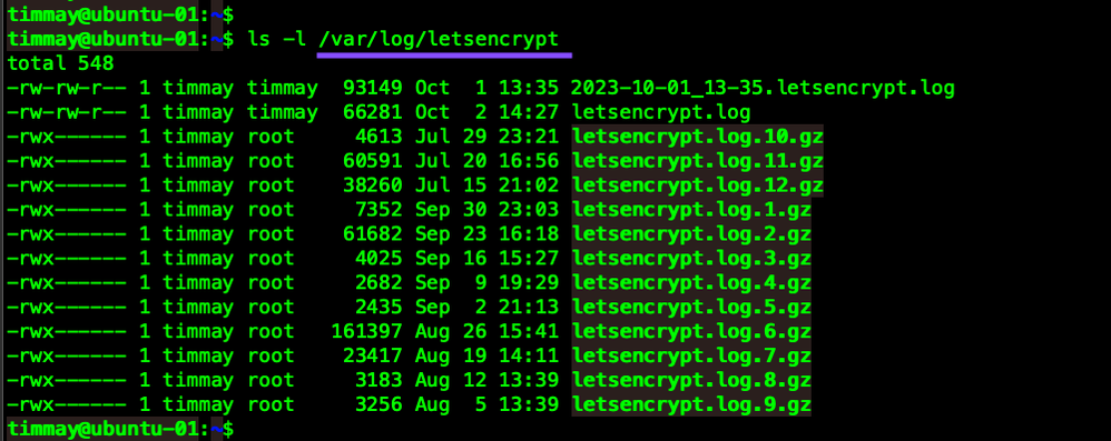

Certbot Logging
Certbot stores all its logs in /var/log/letsencrypt
They are in text format and can be viewed using any standard text editor.
