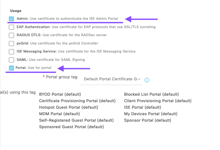

Assign the Certificate to the ISE Service
I like using Let's Encrypt certificates for both the Admin and Portal services.
