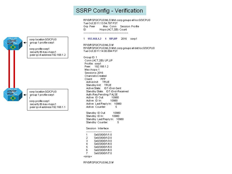

The configuration for SSRPis highlighted in different articles, but for arguments sake of this Q&A a config snippet is highlighted:
Interface configuration (Required on EACH serial and mlp interface that needs to be sync’d)
interface Multilink0/3/0/0/1
ipv4 address 30.30.34.2 255.255.255.252
ssrp group 1 id 10001 ppp
encapsulation ppp
ssrp location 0/3/CPU0 << specifies a slot that is subject to synchronisation
group 1 profile ssrp1 <<< define the group (unique group per LC) and attached profile
ssrp profile ssrp1 << profile definition
security ttl max-hops 1 << TTL hops
peer ipv4 address 192.168.1.2 << peer addr (this peer address needs to be in the same vrf as all multilink interfaces)
