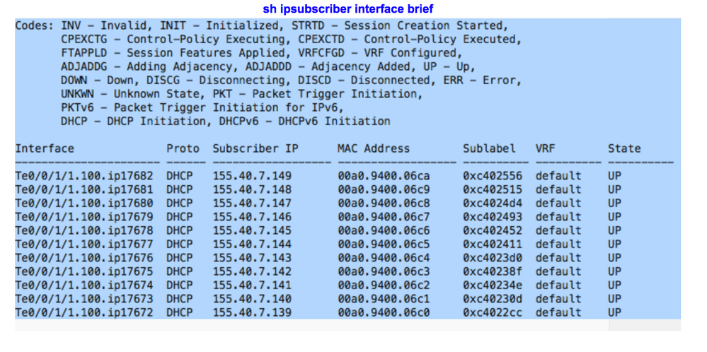

 Verify over all subscriber session & interface statistics :

Only SRG master will hold these stats
