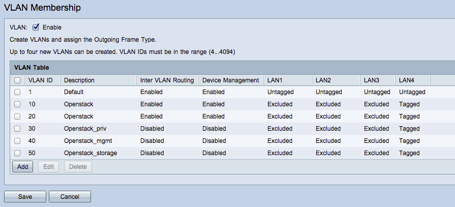

I am having a problem where I cannot get the inter VLAN routing working correctly and I was hoping someone can help. I had all this working with another router so I am happy that the switch configuration is correct and its something to do with the router. I have provided the configuration information below:
VLAN ID 1: 192.168.1.0/24 - Router: 192.168.1.254
VLAN ID 10: 192.168.10.0/24 - Router: 192.168.10.254
VLAN ID 20: 192.168.20.0/24 - Router: 192.168.20.254
VLAN ID 30: 192.168.30.0/24 - Router: 192.168.30.254
VLAN ID 40: 192.168.40.0/24 - Router: 192.168.40.254
VLAN ID 50: 192.168.50.0/24 - Router: 192.168.50.254
LAN PORT 1 = 192.168.1.0/24 (Office LAN)
LAN PORT 4 = VLAN TRUNK
I can ping the router address (10,20,30,40,50).254 from the 192.168.1.x hosts, however I cannot pings hosts on the .10 - .20 networks. The router it self can ping hosts on the .10 and .20 networks fine.
I have the inter VLAN routing enabled for the two networks I care about 10 and 20 so I am not sure why this isn't working. How can the router ping the hosts on all networks but the hosts cannot ping across subnets.
Please see images attached for Router configuration.

I dont have an answer for you "yet", but I do have a couple of questions:
1- What device is being used as the DHCP server for the other VLANS?
2- What is the default gateway you are using on VLANs 10 and 20?
3- Just out of curiosity, have you disabled your windows (or any other firewall) on the PC's you are trying to ping to and from?
Please let us know.
03-20-2015 04:45 PM
I manage to resolve the issues has something to do with one of the hosts i was using to test this out.
Thank you for the help
