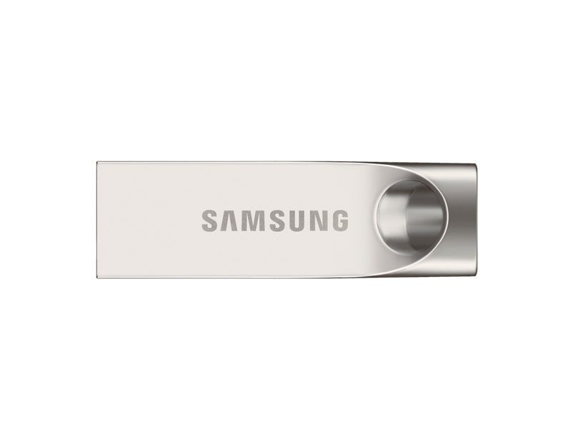

Leo Laohoo
Depends entirely on the size and manufacturer of the USB flash drive.
I've got pretty good success with a 16Gb  Samsung Bar (image below).
Samsung Bar 16 GbSamsung Bar 16 Gb
