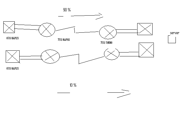

Hello
you can find the info you need in the attach
Regards
What I had thought is to place this command on the both sides of the WAN ATm links
What do you think about:
Router(config-if)# ip load-sharing per-packet
in the attach I place a sample ( Sorry its not a Visio doc )!

Hi
