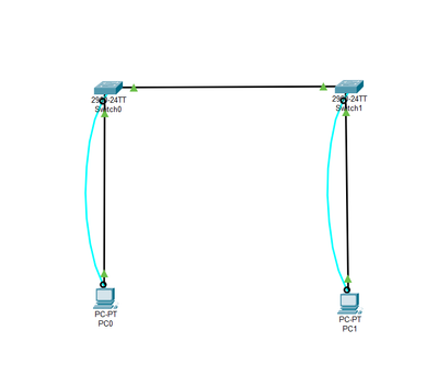

After configuring all the devices, i tried pinging pc0 to switch0 and pc1 to switch1 which results in time out in all replies. Can anyone identify the problem here? I can't seem to identify it. My topology is attached below, any help/tips are greatly appreciated!
Switch0 is assigned with IP address 192.168.1.2
Switch1 is assigned with IP address 192.168.1.3

Hi @sushriya1009
You can attach you pkt file here, just zip it first.
It was unclear to me if you added the ip address on the switch or PC.  If you added those IP on the PCs and all the interfaces on the switch are on the same vlan, you should be able to ping.

Hi @sushriya1009
 Find attached the file.  I can ping from PC to switcn and from switch to PC.
Switch0 192.168.1.2[
Switch1 192.168.1.3
PC0 192.168.1.12
PC1 192.168.1.11

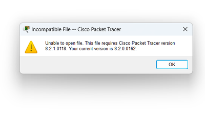

Hi @Flavio Miranda
Thank you for your assistance. I am unable to open the attached file as there is a compatibility issue between the versions. Is there any other way for me to open the file you have attached or could you provide me with any alternative to this.
Hi @sushriya1009
 You need to upgrade your PacketTracer. Mean while, Let me share the config here and you can run on your devices

Hello @sushriya1009,
As concerned switch0, you need interface vlan X (SVI) with ip add 192.168.1.2 255.255.255.0(?)
The switch interface in front of PC0:
Switchport mode access
Switchport access vlan X
No shut
Pc0 ip add. configured with its IP 192.168.1.1 and mask 255.255.255.0(?). --Same subnet as SVI.
Ping between PC0 and Switch0 should be OK!
Same idea on the right side fort PC1 and Switch1.
Between Switch0 and Switch1 it is a Trunk link configured:
Switchport mode trunk
Switchport trunk allowed vlan X
Then PC0 should ping PC1 and vice versa.
Best regards
Hello
As those two pc are i the same subnet you will not require any additional routing whatsoever, the pcs don't even require a default-gateway.
All you need to do it enable of four switches ports as access-ports in the same vlan and you should have reachability.
