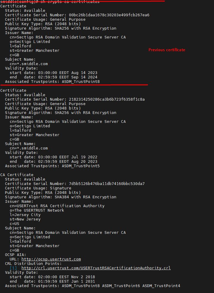

ASA certificate adding sequence
Hi Guys
Need to renewal certificate for vpn on ASA Virtual applince
I have chain of valid certificate issued by certigio including wildcard-cert for domain, but every time got error while import the certificate (error in saving certificate, failed import, Certificate does not contain device's General Purpose public key
for trust point and etc..). Please, explain to my how sequence right for it and which exact certificate must be converted?

Where did you generate the CSR before you handed it over to issue the certificate? was it generated on the ASA? if not, please generate the CSR on the ASA and hand it over to the certificates team to issue a new certificate. Also, do you still have an RSA keypair applied to ASDM_TrustPoint1 trust point? I'm assuming that you still have it because you are renewing the VPN cert, but I'd though it worth checking.
Right, your discribing is absolutely correct!
I have chain of three .crt certificate generated by SSL service provider including usertrust, domaintrust and wildcard, without any rsa or privat key, but I do not know the way of genereating CSR.
Nevertheless, on ASA device available RSA keypair for previous trustpoint ASDM_Trustpoint8. As I understood, I have an issue exact with privat_key missing.

Just to clarify this a bit more. You can import a root CA and an intermediate CA certs on the ASA without generating any CSR because generating the CSR for those is not required. However, if you want to import an identity certificate to the ASA like the one that you will be using for the VPN, then generating the CSR would be required.
Now the CSR could be generated on the ASA itself simply because it is supported, or it could be generated out of the box, usually we generate it out of the box when the the device does not support generating the CSR.
Assuming that the CSR is generated on the ASA, once you have the CSR generated it you hand it over to the certificates team to issue the identity cert, and then once they share the identity cert with you you import it to the ASA. On the other side if you generate the CSR out of the box, then you need to import the private key that was associated with the CSR alongside the identity certificate.
Please notice that on the last screenshot you shared it shows that the VPN certificates used on the ASA are associated to two different trust points and probably each trust point has a different RSA keypair associated. This leads me to think that maybe this VPN certificate was "renewed" simply by going through the same process as a new certificate without relying on any previous data such as a keypair and not even using the same CSR.

Thanks, but I reading so many guides, blogs and another, unfortunately it doesn't  work for me!
I better rephrase my question, which way can I substitute a wide domain certificate, not generated on ASA, but issued by a third-party publisher, via CLI ?

If the wildcard cert can't be created via the normal CSR process on the ASA and has to be imported via a PKCS12 file then the command to import it would be "crypto ca trustpoint < reference the trust point you created in step 2 > pkcs12 < type the PKCS12 file password >". In this case in addition to the identity certificate, the PKCS12 file would include the private key that was used to request the cert.
ŠžŠŗ, got it, thanks..
I think this is the issue, I do not have a private key, all I received from the cert-team is an archive with certificates but not a private key, can they get it by contacting the service that issued the certificate or can I generate it based on existing certificates?

You're welcome. The private key would be owned by the team who generated the CSR of this certificate. It could be stored securely at somewhere from the previous renewal, someone must have it. This wildcard cert would also be installed somewhere else in your company right? I would ask the other teams in the business and see if they could export the private key from somewhere. Alternatively ask the certificate provider to send it to you in a PKCS12 file, that file will then include the certificate itself, root CA, sub CA if used and the private key. Once you have the PKCS12 file you can just import to the ASA.
Unfortunately, it is impossible to get PKCS12 file from the publisher, for generate a certificate in any format, it is necessary to reissue fully chain.One more approach it's exported from somewhere or find mail letter with private key, for me both way is from fantastic land
