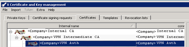

Using XCA I have created a CA, an Intermediate CA, and a 'client' certificate.

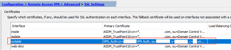

And on the SSL settings I have configured the outside interface to use this identity certificate
