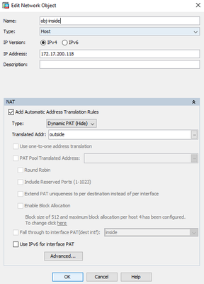

I have added 2 network objects as in the screenshots below.
My Cisco ASA internal IP is 172.17.200.118 and the IP obtained by anyconnect is 10.10.20.45.

Yes. I added those rules with Add "Network Object" Nat rule(please see the captures bellow)
friend
what these IP you use in object group ??
10.10....
172.17.....
172.17.0.0/32 is the network range from the internal company network.
172.17.200.118 is the internal IP of Cisco Firepower.
10.10.20.0/24 is the VPN POOL that is given to the Anyconnect clients
