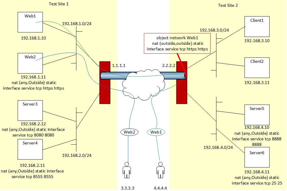

We have two test site locations which are connected by an IPSEC site to site VPN tunnel across the internet (homed on an ASA at each site). We are attempting to setup an environment to test two web applications running side by side. Both of the web servers are running at Test Site 1. We only have single public IP address available at each site.
In order to overcome the single public IP address limitation at site 1, we are trying to setup ACL and NAT rules to have Site 2 accept the traffic coming from the internet and send it over the site to site tunnel. So Web Server 1 would accept internet traffic from ASA 1, and Web Server 2 would accept traffic from ASA 2 at the other site. Here is a network diagram:
We are having trouble getting this setup to work correctly. Please note that clients on the 192.168.3.0/24 network are able to access Web1 and Web2 servers. This issue seems to be due to our NAT setup. Here is the type of error we are seeing on both firewalls:
Asymmetric NAT rules matched for forward and reverse flows; Connection for tcp src outside:4.4.4.4/443 dst outside:192.168.1.10/443 denied due to NAT reverse path failure

Also,
I noticed that in your post you mention Web 1 would be hosted through ASA1 and Web 2 through ASA2. The picture attached again would hint the situation is otherwise? So take that into consideration with the above configurations.
I have done them considering that Site 1 will have simple Static PAT for Web 1 and Site 2 will have more special NAT configurations for Web 2
- Jouni
