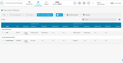

this one here ?
attached NAT and Config
the internal Network is 95.0 connected  and i didnt setup any other routes or not intentionally anyway?

You've two Manual NAT rules, the packet-tracer is not matching the one you created. Although they appear to do the samething.
Manual NAT Policies (Section 1)
1 (inside) to (outside) source static NGFW-Remote-Access-VPN|natIpv4Grp NGFW-Remote-Access-VPN|natIpv4Grp destination static NGFW-Remote-Access-VPN|natIpv4PoolGrp NGFW-Remote-Access-VPN|natIpv4PoolGrp no-proxy-arp route-lookup
translate_hits = 1, untranslate_hits = 1
Source - Origin: 192.168.95.0/28, Translated: 192.168.95.0/28
Destination - Origin: 192.168.19.0/24, Translated: 192.168.19.0/24
2 (inside) to (outside) source static FDM_Local_Network FDM_Local_Network destination static Anyconnect_Pool Anyconnect_Pool
translate_hits = 0, untranslate_hits = 0
her eis my NAT rules one was in already and the other i created on your advice yesterday ?
